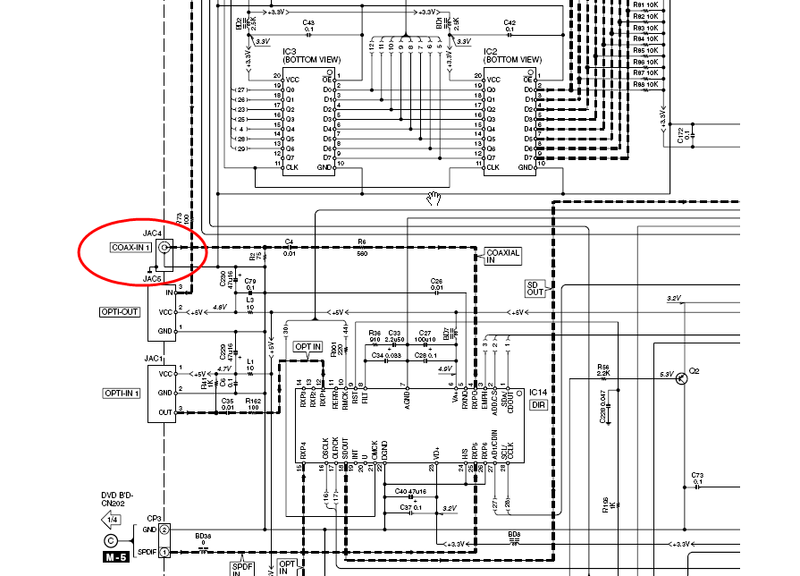

Also, just thought of something else you should check. While it has nothing to do with the power issue, it is a rather idiotic design issue that caused major problems with the unit mainly in the DSP circuit;
As a precaution, make sure to check the ground lug solder connection on the coax-in jack on the DSP board.(along with the screw that connects it to the back panel). For whatever reason, that is the only ground connection for the DSP circuit and if cracked, it can easily ruin several IC's on that board due to floating ground.

thanks vtech for the tip on the screw and ground lug. Interestingly, I had removed the mainboard to remove and check the caps that I suspected were leaking (they were fine). When I put it back in yesterday, I put just a couple of screws in the back to hold things back together. The screw you reference happens to be one I did put back. I did that just because it was near the center of the back panel and it served to hold things. (lucky!)
I just now put all the screws back in. I am hoping that there weren't other situations like the one you covered. Why in the world??
