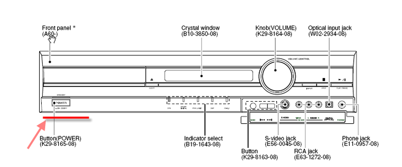

Also, I know there is some sort of an opening on the front bottom corner of the unit where you can reach in and turn a gear manually that opens the tray--just not sure of it's exact place, may even be a small window?

Per your direction, I found a slot under the unit, through which, I moved a lever to open the DVD tray. (now I can remove the front cover and the DVD tray). I then turned everything on... But still no reaction from the DVD player. The tray remains in the position I manually leave it and the disc drive never begins to turn. It doesn't seem as simple as not having power since the words: "DVD/CD" leave the display when that is selected. The portion of the display showing which speakers are selected remain on. Go figure. It seems the voltages from the power supplies are pretty close to normal. And, of course, there is no schematic for the board that interfaces with the drive.
