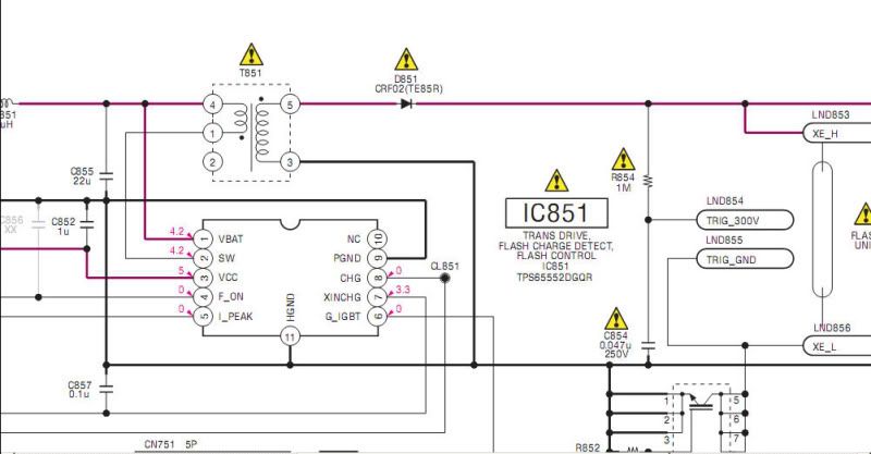

I had to change one of the main fuses on my Sony dsc-w7 but now I can't locate the flash fuse!
Can anyone help?
By the way, the camera is giving error: E:91:01.
And yes, I already reset the camera.
The camera works fine but when I select "flash on" it tries to charge the flash and then it gives me that error.
Thanks in advance.

Can anyone please help me to identify this component?
Thank you.

It appears to be a surface mount fuse. (Do remember Sony using the 32V surface mount fuses on many of their products. Not sure of the amperage value but you could always try 1.5 to 2 A pigtail in its place for testing purposes. what do you read across the device? (ohmwise) |

I got it.. It's a diode.
Called D851 in the service manual..
The problem now is that the service manual doesn't tell it's specs...
So now I'm stuck...again..
RJ. |

This is the broken diode...
Can anyone help, please?

D851 is a fast recovery 800V .5A diode, Generic part#:CRF02 made by Toshiba

Do you think it's safe to use a diode with more voltage specs?
Thanks again.
Rui. |

You can always go with higher breakdown ratings provided there is no space issues involved but, try to keep the switch timing as close as possible. |
