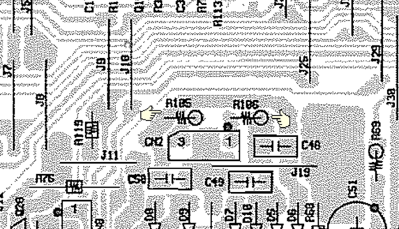

R105 and R106 are underrated resistors. In my receiver, both of them failed.
Replace them both with 1.0 Ohm, 1 Watt Flameproof resistors.
To verify that this is the problem, measure between chassis ground and the front board connector labeled "+15V" and "-15V". If either or both of these voltages is/are missing, the resistors have likely failed.
The correct repair would be to fully disassemble the receiver and solder from the bottom side of the board, but you can test your fix by clipping out the old units leaving leads long enough to solder new resistors to.

Thanks for the info, my Denon has these symptoms. However, my eyes nor my son's good eyes can find r105 106. If there's anyone out there, can you give us a clue? thanks

Looking from the top of the board, both R105, R106 are next to a CN2 connector. As it was said, use a 1 ohm, 1 watt resistor in place of them. They are underrated and simply act as a protection for plus/minus 15V lines.

I had the persistent "PROTECTION" at start as well. When I tested the +15 and -15 volts, they were there. I still replaced R105 and R106 on a hunch. It completely fixed the problem. Took 30 minutes!

I had bogus voltage readings at CN1 so I snipped out both R105 and R106, which were pinned very close to the board. I couldn't get reliable readings on the old ones. Practically had to burn holes in the board to get the new resistors installed, but it WORKED! Got about 15.5 V +/- at CN1.
Mitch and vtech, you saved me ~$200 and a couple of weeks without a receiver. The parts cost me $4.07 (they are monsters compared to OEM) and I enjoy this sort of tinkering. This is my first time on the site and I need to find a way to contribute in appreciation for your contributions.
