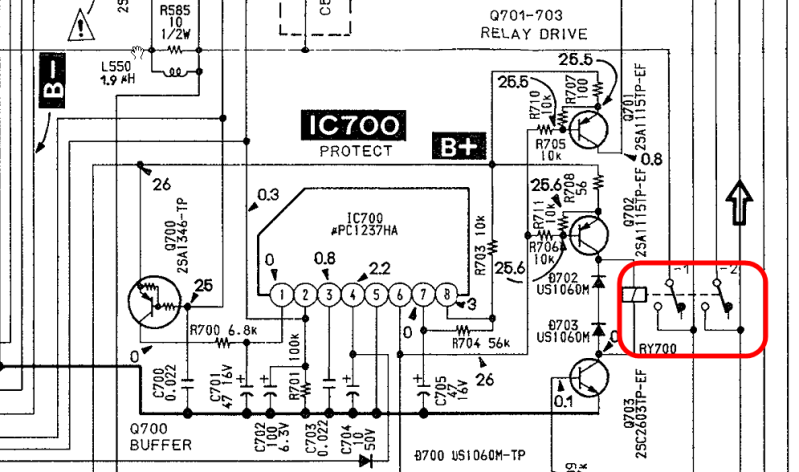

If it is not a solder connection issue, it is likely the relay itself(RY700). Next time, if it happens again, try taping the relay case instead of taking the cover off. Although not common with that type of relay, you may have tarnished internal contact or a hanging coil.
Here is the protect circuit as a reference
