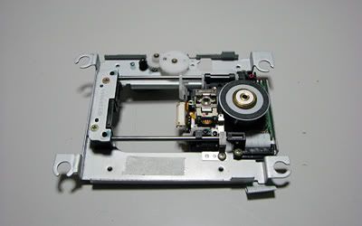

Hi I tried the eraser but it didn't work. I attempted to change ends like you said, but after taking out around 30 screws I still couldn't find the other end.
If I just bought a new motor, do you think that would do the trick?

In order to get to the other end of the cable, you would need to take out the entire assembly to gain access to the connector on the RF board. It is usually no more than 4-6 screws if you are familiar with the unit and know the sequence. I can see where you got the pickup and rather surprised! As a rule of thumb, DVD pickups always require some sort of tangential adjustment(Hex allen screws covered W/blue locktite) for proper operation especially on high-end home players. That is why it is mainly sold as an assembly by the manufacturer.
What I was referring to is the mechanism assembly pictured below. Already preset and ready to go. All you need to do is to remove the shorting plug before putting it all together. You would still need to get the entire assembly w/tray out in order to replace it. Apparently there are also software upgrades for this unit and quite honestly, before spending any more money or any further tries I'd suggest let a servicer handle that.
